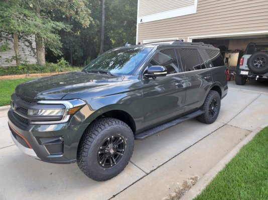

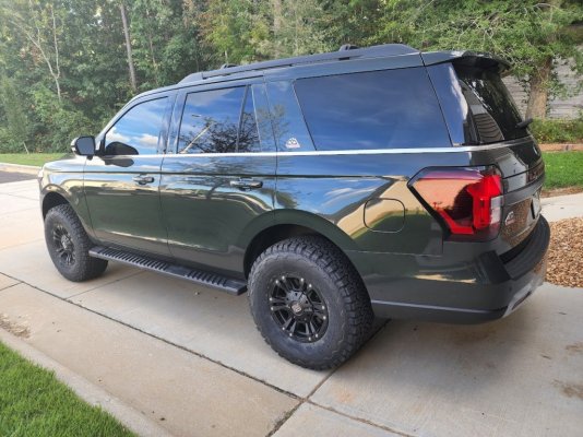

ak49
Jul 23, 2022
65
65
Alaska
ready lift 1.5" front and rear. 35" BFG KO2 tires XD monster 17" wheels.
I've been wanting a mild lift for my Timberline and this looks like what I had in mind. Did you use the Ready Lift 1.5" made for the front on both the front and the back? If so, did this require any other modification? How is the ride compared to stock? Would it be possible for you to measure from the center of your hubs to the top of your fender on the front and rear. I'd greatly appreciate it.
