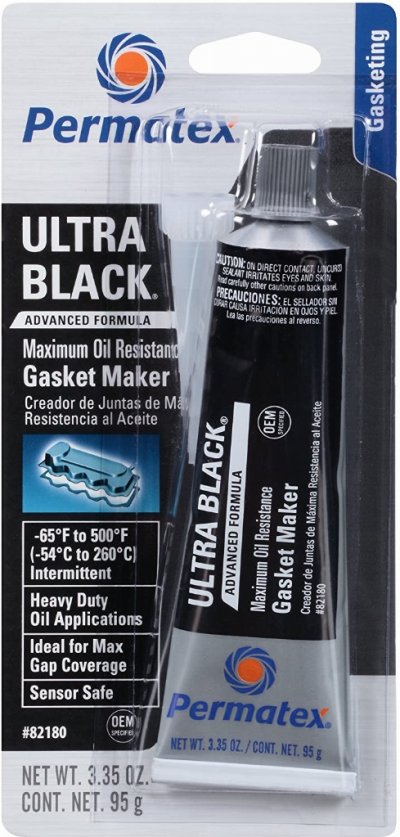

Where on the timing cover is it leaking ? Clean off the area with brake cleaner spray and check the torque on the retaining bolts. The gasket itself is in a channel in the timing cover so it's not going to just slip or blow out. It's an extensive job just to replace the gasket. You might as well do the timing chains and guides, water pump, ( cam phasers, oil pump....) while you're there 'cause that's how much you have to do to get to those components anyway. I just did all this on mine and it's not that much fun. Installing a high volume Melling oil pump and running 10w-30 oil will save your motor in the long run. The good news is the 3V motor is slightly easier to do than the 2V motors because the valve covers are shallower and fewer bolts. Use some super glue in spots to hold the valve cover gaskets in place during re-installation. They slip out of place easily and that'll lead to big oil leaks. If you re-torque the timing cover bolts now, you may be able to seal the small leak you have with some Permatex oil resistant silicone and that would get you by for now. Get some anyway, cause you'll use it if you go any further in the motor.
https://www.amazon.com/Permatex-821...76504915&sprefix=Permatex+oil+,aps,188&sr=8-1
