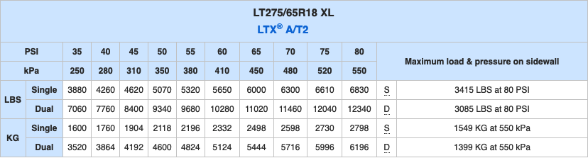

ETA According to the Toyo chart an LT tire needs around 5 psi more than a stock P metric tire for the same load rating
