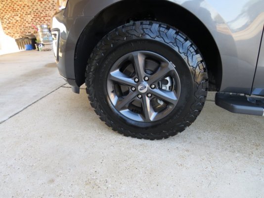

I have a '21 FX4 that came with Michelin Primacy 275x65x18 all terrains but P rated. Went with 275x70x18 BFG KO2's that are 10 ply E rated that weigh 57 lbs ea. Bought these for minor offroading and towing our almost 8K pound camper. About 1 mpg loss in fuel mileage and some decrease in braking but not bad at all. Still can get up to 22 mpg hwy and 17 to 18 mpg out in the country town where I live. The FX4 has the max tow package with 3.73 gearing ..trailer backup assist and brake controller. Very pleased with these tires and run 42 psi cold for daily use and air them up to 60 psi when towing. Have 8K miles on them and no signs of wear.
