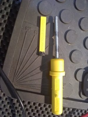

My dipstick snapped off and apparently isn't made of ABS as ABS plastic solvent didn't stick it back together (black glue in pic). I cut off the remaining stub of the broken dipstick, drilled/tapped the handle for a 10-24 bolt, glued it in with 5-min epoxy (you can speed it up drying with a heat gun), then cut the bolt off at 47mm like the stock dipstick. Permanent marker a few 1/2" or 10mm increments and aim to fill ~3/4" or 20" from the top.

Broken stock dipstick left (black is failed ABS solvent repair) and drilled/tapped screw epoxied in handle and cutoff to 1-7/8" 47mm.

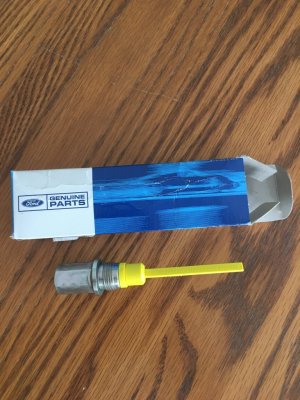

Fluid/ filter change. Also here is the replacement dipstick I used, my original broke as well:
96BBF231-CC33-4015-8F1A-3990197777D3.jpeg 2D7EF4DF-C8B6-4CF2-AF52-EEDBE5DC600C.jpeg
