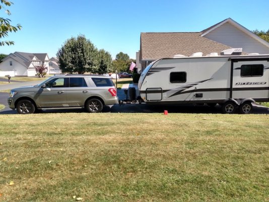

Additionally a boat has its weight much lower as opposed to a big shoe box on wheels....isn't affected by wind or passing vehicles as much as a big box. I've pulled both and by far a boat is much easier to pull.
What surprised me towing with the Expy is that passing vehicles barely affect the entire rig even at the 65-70 mph speed. Very stable platform.
My rig......
