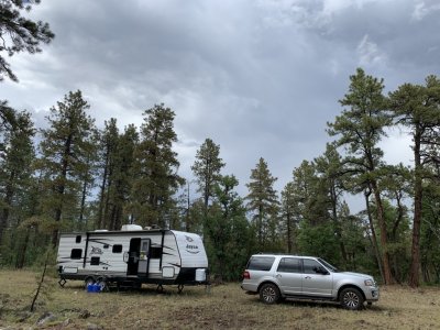

I tow a 2018 Jayco JayFlight 267BHWS (5,660lbs dry and around 6740lbs loaded up with full water tank). 2017 Expedition tows it fine but watch your engine and transmission temps on any big climbs. Also, make sure you have a quality WD hitch.
