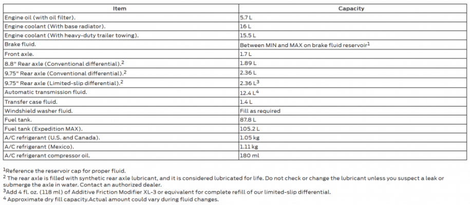

Does rear differential have drain plug like older Expedition or I have to crack the case like F150? I'm going to use Valvoline synthetic 75-90 for both rear and front axle.

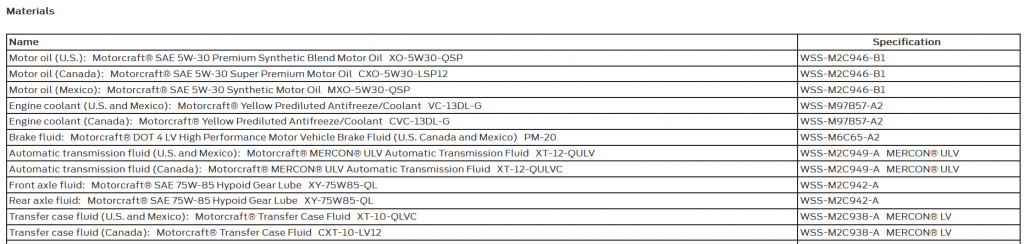

Do you recommend to use anything else except Mercon LV for transfer case?

The rear diff and transfer case are very easy to service since they have a drain plug. I did both last year. Bought a small hand operated fluid pump. For the front diff, it is probably easier to suck the old fluid out from the fill plug since the cover is very close to the steering rack.
My transfer case (with 4A) has a big warning saying “use Mercon LV only”
for the rear axle, since mine has eLSD, I decided to stick with the recommended Ford 75-85 plus the friction modifier.

I just did the rear differential fluid today and it was easy process. I had to run to the store to buy the torch since those plugs would not budge and I didn't want to damage them. Over 2 quarts came out and the fluid was muddy black.
There were a lot of metal particles on the magnets. I cleaned the plugs up and reused them with red thread locker. I pumped in around 2.5 quart until the fluid drained out and trickled from the fill plug. Torqued the plugs around 18 ft/lb and called it done.
I couldn't do the transfer case or the front axle because I do not have the Mercon LV on hand and I have about 1.5 quart of Valvoline 75-90 left. I think front axle uses around 1.9 quart. I may wait until 30k miles to tackle them.
