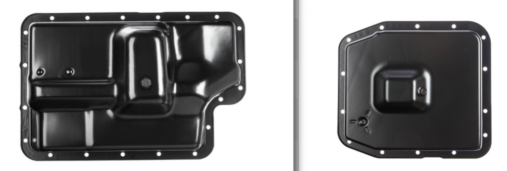

I am no definitive source for this, but it appears there's only 2 possibilities the 4R70W and 4R100. The 4R70W being by far the most common in our Expeditions. They are quite different transmissions so you should be able to fairly easily identify them from the case and the fluid pan. Below is a pic of the fluid pans 4R100 on the left 4R70W on the right.

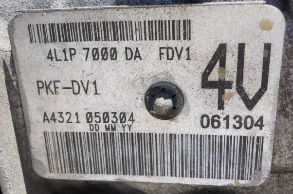

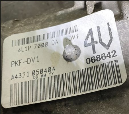

A quick search on eBay identified the label location, the eBay sellers often take and post lots of pictures so it's a good resource for this.
The 2 pictures below are reported as a 2004 Expedition 5.4L and we know it's 4WD from the tail shaft housing. Due to heat shields you will likely have to climb under your truck and slip a thin camera up beside the transmission and take a picture of the label to read it, a cell phone might work.
I found another pic identified as a 2004 Expedition with 5.4L that is clearly a 2WD transmission with ID 4L1P CA. So it would appear that the list in your previous post is accurate and we have a 4R75W/E transmission as opposed to an actual 4R70W. Interesting to me. I thought the 4R75 started in 2005.

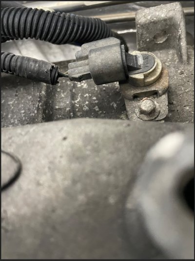

I know where the output speed sensor is, I'm not sure where the input speed sensor would be. Looking at AllDataDIY it appears the 4R7xW output speed sensor is on the driver side near the extension housing. The only place I see another speed sensor is the input speed sensor on the 4R100 which is clearly not the transmission in my truck.

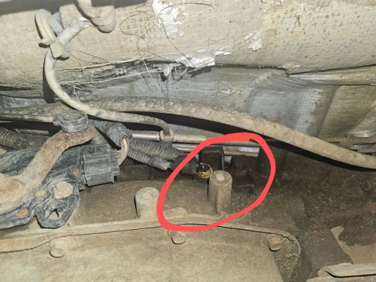

That's one sensor, located near the shifter.

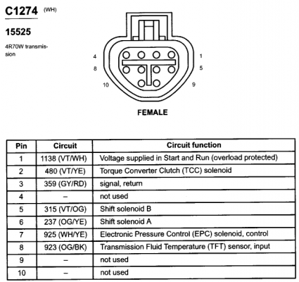

I finally got time to get under the truck, sorry I have worked nearly around the clock for several days now. Anyway, I found just 3 connectors and they match the diagram below, only 1 speed sensor. I took a pic of the speed sensor and the main connector, the only other connector is the range sensor.
