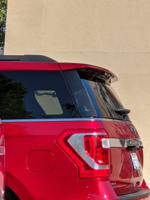

Brought the Expy to the car wash on Friday and as I was sitting there watching them dry it off, I saw this. What the hell is that weird sheen spots on the back of the truck? I never even realized there was a huge piece of unpainted plastic at the back of the truck until the light hit it and I could see it looks like pearl oyster or some shit. Upon closer inspection it has all kinds of swirl marks in the plastic. Now, this truck has never gone through a car wash. I bought it with 13 miles on it, and I've never taken it to one. So it's not from a car wash... it's just deformations in the plastic.

Yup. Piano black plastic is the bane of my existence when I am detailing my vehicles, and the B pillar and D pillar on this truck sucks for it. That scuff you got there is among the worst I have seen, but it likely can be polished up. When I got mine it looked like the dealership dried those areas with 200 grit sandpaper.
If you hit it with some good, fine rubbing compound then follow up with a finer swirl-mark remover you'll likely get about 95% of that out. Finish it with a good wax and you should be good to go. What I have also found is that I have to use brand-new microfiber towels when I buff it, or it seems to leave as many swirls as it removes.
If it is so bad that the top layer of plastic is compromised, you may have to just have the dealer replace it. If it truly is deformation in the plastic they may do it under warranty. Typically that is not a difficult or expensive piece to replace.
Good luck.

That junk scratches so easy, I hate washing it. I often wash it first so there is no chance of any extra dirt being on my washing brush. Its on my wife's Flex too and I've managed to keep it looking pretty good, but its always scratched to $hit if you look too close.

Mine almost seems more like stains than scratches, but a bit of rubbing compound takes care of it and a coat of wax slows it down from happening in the future. Not a durable surface for exterior use. On the Stealth package, are the black mirror housings the same material, or are they painted black? Hopefully those mirror housings don't have the same issue.

Mine also looks swirled, scratched and faded. I have been thinking about having it painted or wrapped the body color. Maybe help it look different from a suburban.

A step one polish with a random orbital polisher cleans them right up! Get to it :)

I was going to suggest a similar fix. You could use the same material that they make front end masks with. It’s available through amazon for pretty cheap. Relatively easy to apply and leaves a glossy protected finish that won’t scratch or chip. My front bumper, Hood and mirrors are done with it. And I did the rear bumper and lower skirt behind the rear tires with it. Works great. No stone chips or scratches and it is basically invisible.
