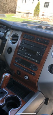

Has anyone successfully installed the ford factory upfitter switches in their 3rd gen expy or how have you do aftermarket switches and where did you put them? Im looking to install concealed switches/ switches that aren’t easily seen and/or look factory

Ill looking at the angled piece of trim under my climate controls, use rocker switches so is flush and a foot pedal

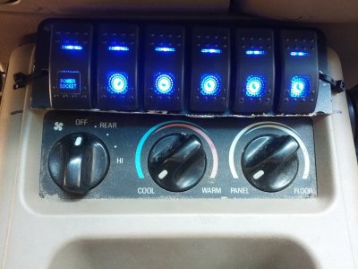

here is my version of up fitter switches, I'm very pleased with the results, and how they look I ordered them off eBay, I put the black zip ties there just in case I ever need to either change a switch, or put in a different style switch panel. there was a blank space above the rear hvac controls, I trimmed it out with my dremel rotatory kit and ran the wires up under the driver's side lower panel and put butt connectors on the wires so that I can use any of the left over switches and they're in easy reach as well. my switch panel after I trimmed the bottom above the rear HVAC controls.jpg
