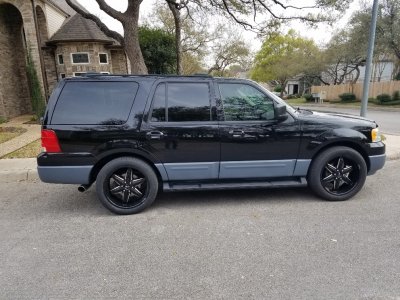

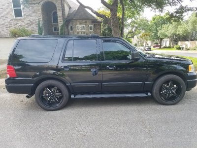

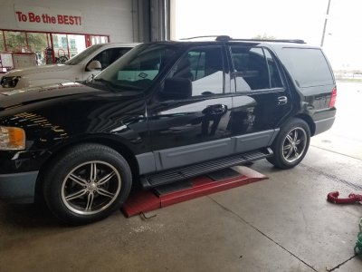

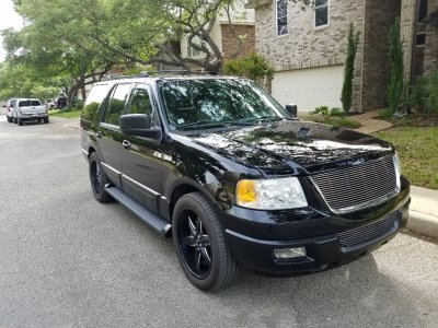

A while back I posted my plan to "restore/upgrade" my '03 4.6L Expy in lieu of replacing it after only 154K miles. The plan included 4.10 gears, shorty headers, CAI, underdrive pulleys, electric fans and 5 Star tune to pull it all together. Had some issues along the way with header fitment and the electric fan install which were all over come; issues and solutions were posted in previous threads. The plan also included some cosmetic changes, more of the "restore" nature which included new 22" Foose wheels, 285/45 Michelins, all dents, dings and scratches removed, new paint, new steering wheel and recovering the front driver and passenger seats. The vehicle had already been lowered with an Eibach springs, sway bars and Bilstein shocks. The OEM radio has been replaced with the latest Sony unit and better speakers with hands free coms, navigation and Android Auto and Car Play for voice activated operation; review camera is going to be installed next week.
The original painting of the plastic door and bumper moldings was supposed to be gray but had more blue than I wanted so I had them repainted matt black; much better. Check it out. One picture with the Liquid Metal 20" Wingman wheels just before installing the Foose 22"ers and one with the 22" Foose wheels, both with the "grey" moldings. The other two are after the molding repaint.
Thanks to the members that assisted in answering questions and making suggestions as I worked through the project. All in all, very good decision. I have always loved this old bucket and with the changes, the attraction is still there. Very good outcome.
