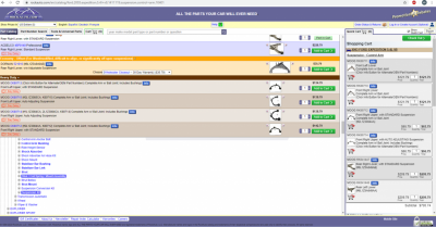

    Sorry I made a mistake I actually went with the Motorcraft upper control arms because I could not find the K series. Quick disclaimer I replaced my entire front and rear suspension and used a combination of Moog and Motorcraft parts (which ever was better) so I confused myself Again sorry
    Note: I also went with Motorcraft Lower Ball Joints
    Rock Auto $115.79 ea
    MOTORCRAFT MCSOE166 {#6L1Z3085AA} Info
    [​IMG] [​IMG] [​IMG] Front Left Upper; w/ Standard Suspension
    MOTORCRAFT MCSOE156 {#6L1Z3084AA} Suspension Control Arm and Ball Joint Assembly Info
    [​IMG] [​IMG] [​IMG] Front Right Upper; w/ Standard Suspension
