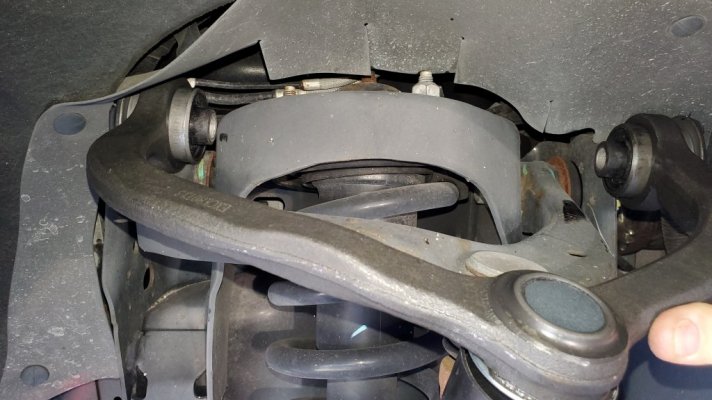

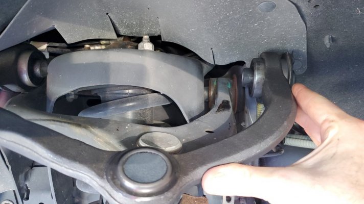

For anyone interested, I pulled the driver's side wheel off the wife's '16 and laid the '03 new Moog upper control arm in there. It's almost 2" wider on the back end. I can't say if the upper ball joint location is the same geometry, but it's close.
If I had more time, I'd build a jig off the Moog's, buy a set of tubular UCA's and modify them to fit the jig. Maybe next time.
