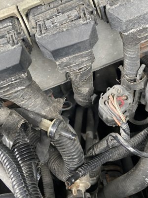

221E219E-74E8-4926-B36A-8B435EA81584.jpeg B3094A99-3D25-44B3-A1FD-5E7D897B1D8B.jpeg CBAD8DFE-FE90-40A3-8FE5-6C30563A5772.jpeg 1EBDAC98-1CB8-404E-8777-AEAA035BFE88.jpeg EE304AC3-CDC3-40B3-BF7E-D01D10B42E83.jpeg EE304AC3-CDC3-40B3-BF7E-D01D10B42E83.jpeg EE304AC3-CDC3-40B3-BF7E-D01D10B42E83.jpeg I have a vacuum leak throwing a po446 code. I found a location of the leak. Can anyone identify if this hard plastic broke off or if it was just a dry rotted rubber hose here ? Also what this vacuum hose is for I tried tracing it back . Thanks !

that looks the one …. on my 2003 … that went and air only blew out the defrost
seems easy enough to fix. just get some hose that fits both sides and bridge, or just use Gorilla tape.

So that was an easy fix. Piece of rubber hose and now my vent blow again instead of just my defroster. Now I just have to figure out why it’s misfiring still

Just hook it back together with a piece or rubber tubing.
Then your hvac direction will function. Most ford trucks have a hose in this area that goes into the dash to control the flaps inside etc.
It's a pretty good vacuum leak so it will cause dip in idle and what can feel like a miss at low rpms. Get it hooked back up, clear codes and see it any pop up or you feel any misses.
