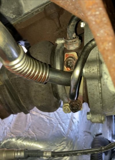

Not really a mechanic but can anyone confirm my belief that I have a leaking water pump from this picture? Also, are there any TSBs out there for these to be replaced? 2016 Expedition 06CC0691-D847-4E55-92D4-CE129DC01F74.png

Sure looks like it is leaking.
Mine was replaced at 75,*** miles. It only leaked when the engine was running, and the leak was small (about a one-inch drop in coolant in the reservoir over one week).
‘I’m not aware of any TSB - but there was an updated pump and pulley kit according to the service advisor at the dealership when I had it replaced.

Yeah it’s only been leaking 2 mornings now after startup for about 3 minutes. Enough to make a small puddle each time. I’m thinking it’s the seal bc after the truck warms up, leak stops completely. Thank you for the reply!
The water pump has a weep hole.
When your water pump seal starts to go bad it lets coolant out the weep hole as a warning.

Additional update. Fords aftermarket warranty solutions will not cover any tube assembly, fitting, connector, etc , metal or plastic unless associated with AC or power steering. So $1022 later I’ll be getting a new water pump (covered, $100 deductible) new Ford lime green coolant flush (orange has been found to wear away components prematurely), and several new coolant hoses on the driver side turbo. $720 for labor… stealership at it again…
