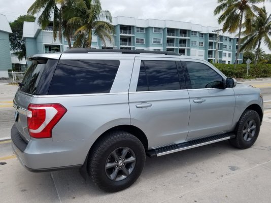

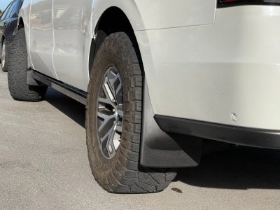

Never been a fan of mud flaps. On previous 4x4's, OEM flaps got ripped off on the trail or went into the garbage.
Figured these don't look too bad and will help keep rocks/pebbles from getting kicked up onto the travel trailer. They fit well and were easy to install.

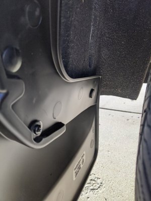

It was one of the first things I ever put on. The bumper on these is shaped like a giant dirt/snow catcher. it also helps keep snow/mud off of the running boards which tend to be pretty error prone in bad conditions.
As a side note, I found that they were a bit flimsy, so I used some extra fender pins and attached the fender lining to them as well. You can see the mud flaps in the attached image and the extra fender push pins I drilled and put in, just to suck the fender liner and the mud flap together.
