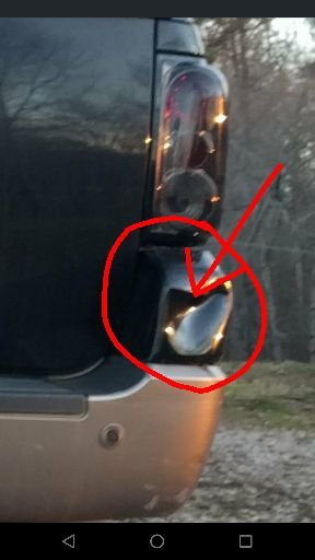

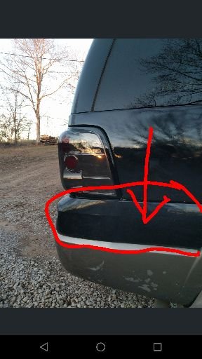

Trying to find this part to replace but hard to do if ya don't know what it is called.. It seems to be a separate piece from the bumper clip.

Bumper Extension, or Bumper End Extension seems fairly common. Available OEM and aftermarket. With and without holes for wheel lip moldings (fender flares)
Example part number would be 2L14-17F001-BHW.
If you have a heat gun, you might be able to form that one back into place.

Thank u very much.. Yea I pondered on using a heat gun and try to get it back out I'm going to see if I can remove it without removing the *****'n bumper. Thanks again

Yea I haven't try to address it yet but I found them in eBay for $100
And no they are not part of the bumper they are separate pieces..

Ok... so there are two answers here. That upper portion of the bumper is connected to lower. So, it is essentially part of the bumper by way of a bracket, and rivets. It is possible to replace it separately. They can be found on the internet. Most commonly they are found already part of the bumper to make it a complete set for installation.
I know this because I’ve changed a few of these out (5 of them). When ordering your parts for the bumper be sure to pay attention to EB vs. non-EB, and backup sensor vs non-backup sensor equipped vehicles, etc.

Take it off the vehicle and heat it up from the inside with a heat gun (NOT a blow dryer) or a propane torch and push it back out. If you are careful you won't damage the paint.

If it was mine I would drill a small hole in middle of dent and insert a small plastic hollow wall anchor, then insert screw and pull the dent out. Could then fill the hole with a dark silicone or finish with plastic patch.
