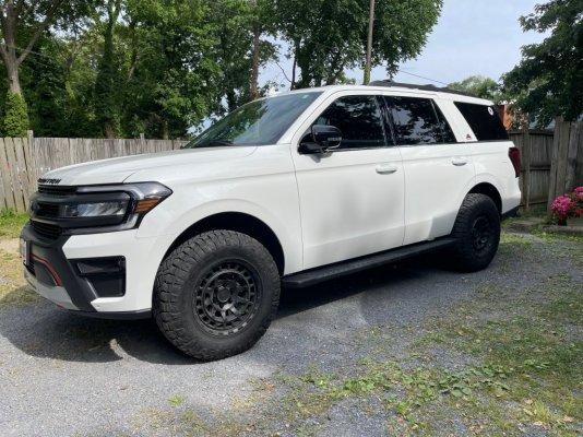

I use Nitto Ridge Grappler LT tires (LT285/70 R18). As far as wheels, that is a personal choice. I have Black Rhino Chambers (+12mm offset) on mine.

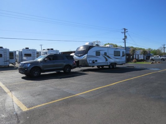

I ran normal 40 psi in my load range E Nitto’s when not towing and pumped up to 70 when towing the travel trailer. Towed like a dream. The EB 3.5 is a freaking tow beast. Very impressive.
