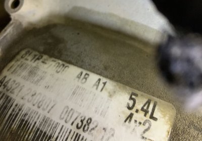

this is all it says for my VIN: Trans Order Code 44E Trans Type 4 4.0 min 4.0 max Trans Description Cont. Automatic w/OD that's it. i looked that up long ago. then I looked up "44E". still got nothing.

AHA!!! got it. the 44E = the 4R70 trans. NOT the 4R100. so there. ford part number for the 44E is 4L1Z7000DARM, AutoZone SKU is 710922. on a side note, nothing burns my ass more than the damn bullshit artists on these web sites. stop talking out of your ass, people. if you don't know, please don't pretend you know. the site specifically exists to help people with information on our trucks, making shit up does not help. it's not like you're going to get a medal. damn!
