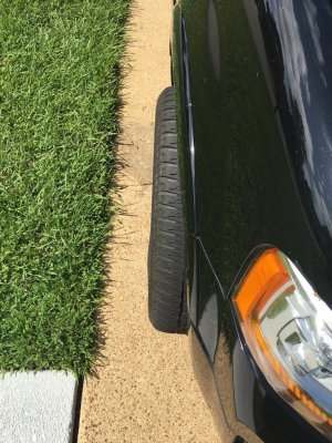

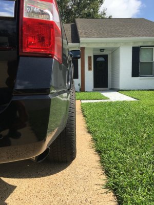

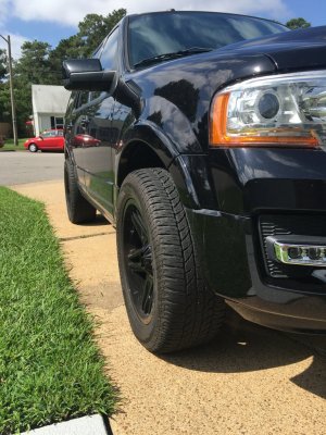

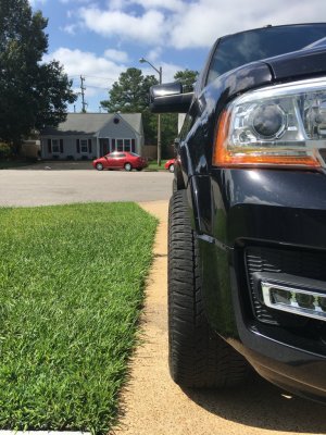

Please take these as nothing other than pictures to show you what +10 looks like on a 20x9 on 275/55/20 Geolander ATs. You will notice this is a 2016 on stock height and that the front wheels seem to stick WAYYY out. This is due to the change in the way the front fenders kind of curve in towards the engine as they get closer to the front bumper. I had no problems with rubbing or trimming. Looks great in person and my wife always gets compliments on how it looks (when it’s not filthy lol)
8A783797-54D0-4006-A213-7C049A8E351D.jpeg 596DA02C-D1AE-482A-A24F-15AC1CB54F2F.jpeg 5ECA0FF1-5211-48A6-9628-5C896B2C0239.jpeg DC656C85-F5FD-4FD7-A685-2744E1CC0381.jpeg
