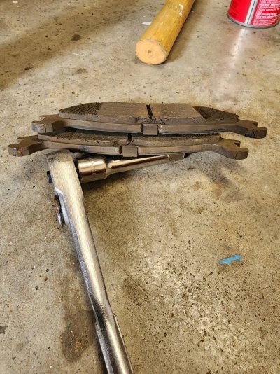

Doing my pads right now... Here is rear after 42k
