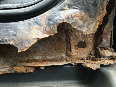

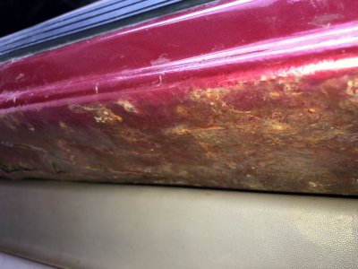

867BEEC9-1636-46D0-80D5-7A3B2A6ABBF5.jpeg 03DBD232-4878-4EE2-9C7D-4661C6039BF9.jpeg I sure like your way of thinking and I'm trying to convince myself it's ok to think that way! I tell myself it took it 14 years to get to this point; it's surely not going to disintegrate in a year or two.
With respect to dousing it with Fluid Film, I'm wondering if it might make sense to go head and cut away some of the rotten part so that I can get "inside" those rockers to treat them with this product or a rust converter or something ?

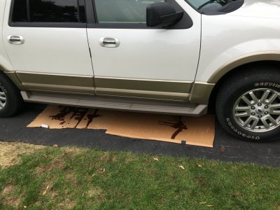

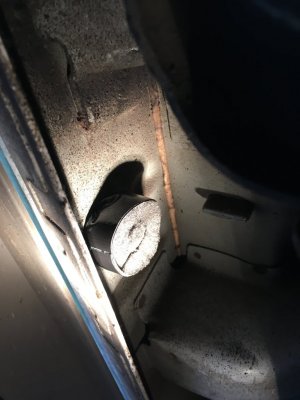

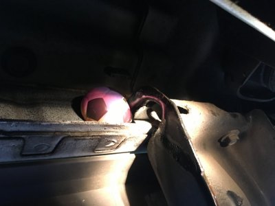

Started the fall "coat & plug rockers" job. Hard to roll around under the Expy and work. Sprayed anti corrosion stuff inside rockers and plugged as many holes as I could with improvised plugs. Sprayed until it would drip down. Going back later to hit several locations underneath with more Fluid Film. This has to help. I dont like rust.
