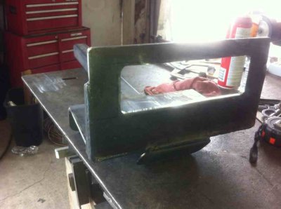

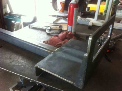

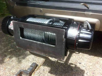

Made a winch mount for my 2003. I welded a hitch in the front so I can use it in the front or rear.

I gotta bolt it down n bolt the fair lead should b done tomorrow. What do you guys think?

all i can say.... F'n Brilliant!!! When I'm rdy.. I was stuck looking at the smitty/warn hitch mounts without the roller mounts.. luv it!!! I'm gonna steal your ideal :)

Do yourself a favor and make your own dont buy that smitty mount they suck. I got my truck stuck in the snow one day a buddy had one so I put it in the rear hitch. Long story short I bent the damn mount pulling it out. They are made out of sheet metal. And the stinger is thin.

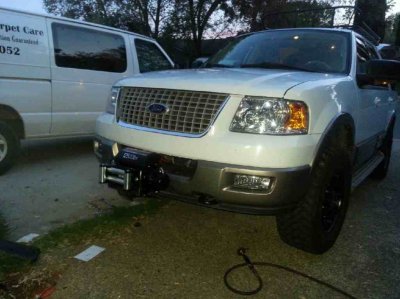

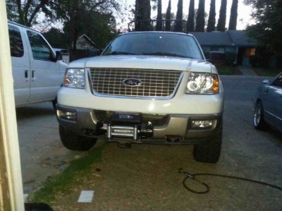

Made a new topic but I should have posted it in here... Here it is finally done.

How did that winch mount work out? Looks like you did a nice job. I have a 2001 Expy. Got stuck in the Tennessee lake muck while on vacation last week. A Flatbed made it out to me and pulled me out. It was stuck so bad that I snapped the front piece off my Hi-Lift jack. I just bought a Badlands 12,000 lb winch and would like to do the same thing. What size winch do you have on there? Joe
Expy530
Mar 3, 2013
49
Redding California

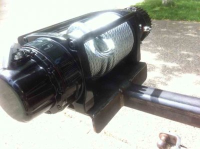

Works freaking awesome! The one I have is a 12500 lbs winch. I think its the same as the badlands. 12500 lbs is kinda over kill but I rather b well prepared n have power left over. Be sure to post pics of your progress! One suggestion tho which I have to do myself is change the cable on the winch althought the winch can do 12k lbs the cable cant.
