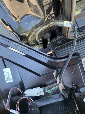

Just found out why led band wouldn't work. The module I bought had some water in it. After taking the module completely apart I spotted rust on the circuit board which means this is pretty much junk, it surprises me that the led pack still works. I'm probably going to pause right here and wait till I can get my hand on another module. As I noticed on the halogen module, red wire is for bright, and yellow wire is for dim. I assume they are the same for the led band.

I'm not so sure do I want to do it even if I can get it working. I don't mind shaving one of the fins off the connector, but needing to cut the wire is the deal-braker for me. There are some wiring skills needed to install it and it's not a very good idea to purchase $1200 non-refundable parts and perform some backyard-engineering on it. If someone is really smart, he can come up with some kind of connector that allows connection from a LED module to a XLT truck without needing to work on module.

Anyone want to compare notes with our F150 brothers? i know to make the switch on an f150 it is a harness and housing change. Anyone have a f150 with the LED tails to take pics of plug and wire colors? i have a 15 XLT so i can provide pics of a basic taillight.... Not sure if it helps but this is an upgrade i would love to have on the epxy.

I was disappointed this wasnt plug and play. I had a LED tail lamp at my disposal today and confirmed the connector just wont fit. The LED unit looks much better but After seeing all that would go into this I think im with the guy who mentioned waiting for $100 Chinese knock offs in a year or so LOL
