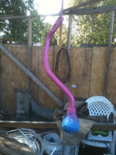

He said with the 396 it had, according to the GPS it did 81 mph. 3 blade prop. apparently more blades faster launch, slower top end... with the dyno'd 454 Alum heads, keith black this that and the other thing, with a 3 blade prop, 1/3 throttle and the boat goes strait up. He is projecting 100 ~ with a 2 blade, and more reasonable launch characteristics.

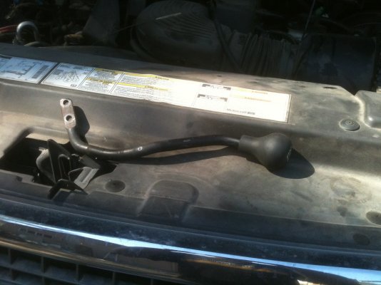

First of the month we should have the missing bits, found a shifter for the t-case today in a local boneyard for $35, shifter and linkage... Expy nosed F150, no idea the year, probably early... Need that, ... oh yeah, slave... and t-case. Looking at S-Duty t-cases (I think it was tha Alaskan kids thread about Excursion Reincarnation), I may have some driveshaft work to address. Expy was slip yoke, and the t-case I saw, was flanged on both ends.

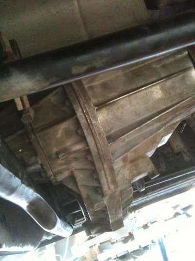

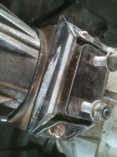

so I got the NV271 in. I said this earlier, and I will say it again.
Drop the Torsion bar mounting area, out of the way. Just f@#$ing do it.
That sucked.

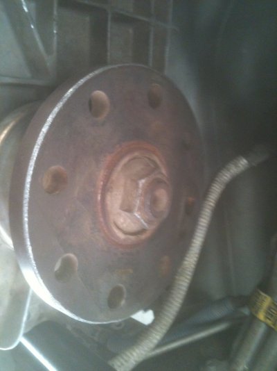

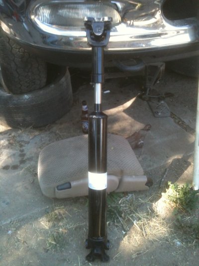

Our t-case is a BW44-06, Slip yoke on arse, flanged front. NV271/273 (3 is e-shift, 1 is mannie shift) is flanged front and rear.
Front shaft, only change that needed to be made was BW flange needs to be replaced with NV flange. Rear, obviously a flange needs added, and then a slip yoke created.

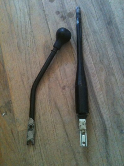

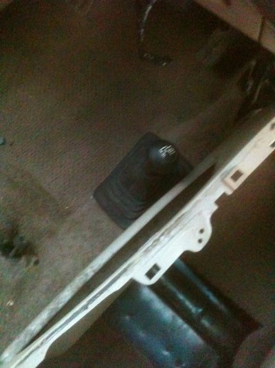

HAve both the SD shifters, but at the crusher yard today, for $10 I got both shifters from a 98 F150, INCLUDING the rubber deally that insulatesthe cabin from undercarriage.

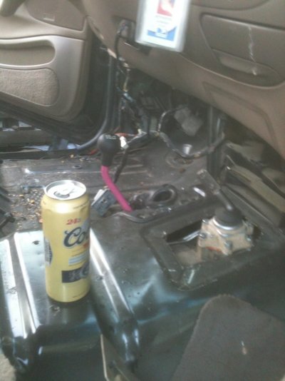

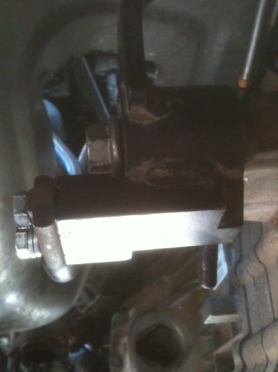

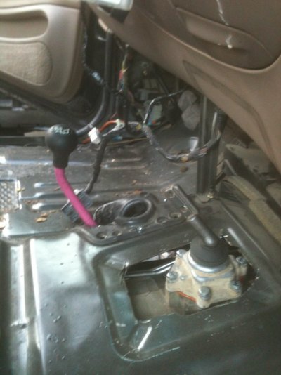

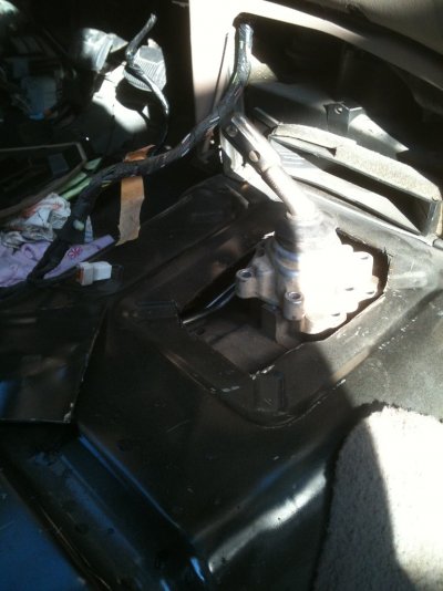

well, notched the floor for the shifter, tomorrow t- case,a dn then we finish hydraulics, button up inside, hook up filter lines.

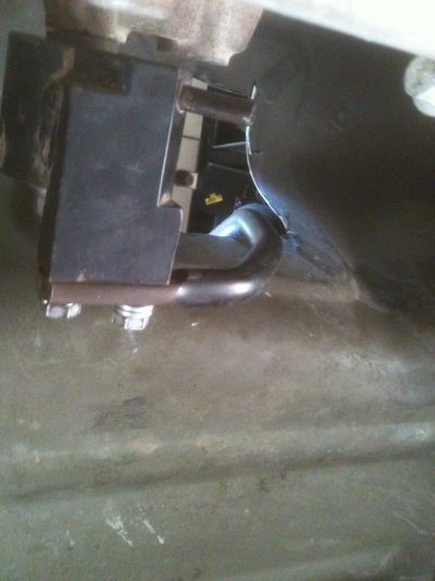

In a key YDMF moment after I notched for the fuel lines, I noticed just how close I cam to the high psi fuel lines with the skinny wheel..
No harm, no foul, but.. be attentive to the cut on the driver side fo the tunnel. HAmmered back down all the metal I had pushed up in the tunnel with the jack arranging the trans.. SEX!
Only concern now is I will have to give the shifter a "retro" dog leg shape to clear the dash.
PArt of crusher yard score, was also the radio bezel that doesn't have the "dial a drive selection" t-case knob :D
If what I mean is escaping up, all the ZF's from the late 80's up had a straight stalk, all the Ford 4 speeds, t-19 and the like have a curvy shifter to avoind dash interference.
