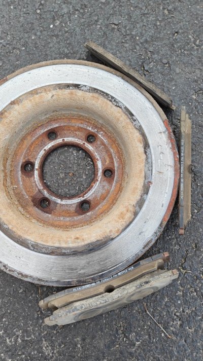

Well, made it 114k km before a rear right pad expired and ruined the disk. One front and one rear may have been able to be turned but that's a bit of a pain when you're out of town and need the vehicle on the road.
Front left wore strangely...very strange. Pad was worn on the outer edges and only making contact in a narrow band in the middle. I did get a sense it was wearing funny but it was pretty subtle under braking. Perhaps the right rear wearing faster is related.
Here's a pic, the pins were sliding properly, I can only assume they were stuck at some point early on.
Any thoughts on this wear pattern?
Dealer was $710 cdn per axle with new rotors, $510 if they could be turned. Parts for ceramic pads and corrosion resistant rotors on both axles were about $430 plus $170 shipping.
Gotta love Rock Auto.
