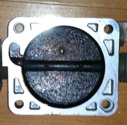

After removing the throttle body cover(three 10mm bolts), look for cracked or brittle hoses in the vicinity. Or melted, as can happen if one touches the EGR valve. If the TB looks anywhere as dirty as the one in the picture, I would follow Hamfisted's advice and remove it so it can be thoroughly cleaned.
