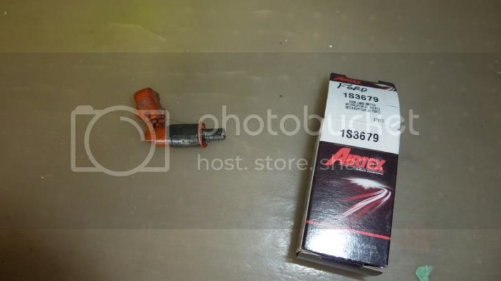

It's a very common problem with Fords, the driver's door jamb switch. Ford in their infinite wisdom chose to put this pin switch in the door locking mechanism. The same mechanism that gets slammed maybe 30+ times a day (maybe more in a work truck...). Anyway I thought I'd post some pics on the removal and replacement of this little pin switch since I haven't found a whole lot out there on the web. If your dome light doesn't come on when you open the door, or any of the other door open functions, this switch is probably your culprit. The switches are side dependent, so order for the left or right side as needed. The driver's door is most common, so that's where we'll focus.
New door jamb switch from Rock Auto (AirTex 1S3679 $23)....

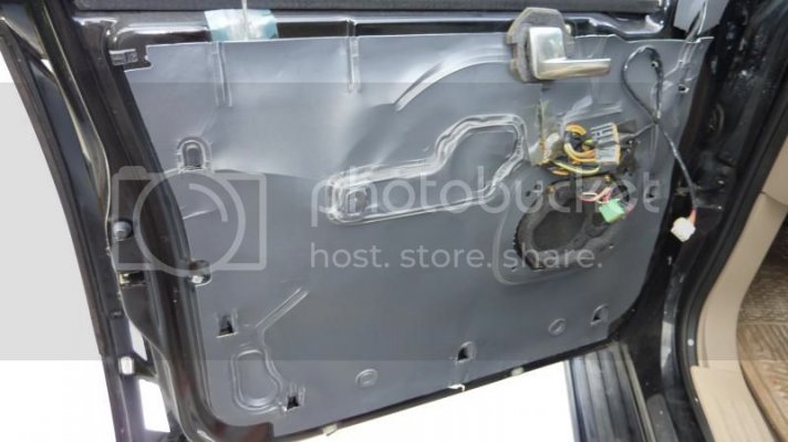

Once door panel is removed you can peel away moisture barrier and fold it out of the way.... it's pretty durable and you won't tear it.

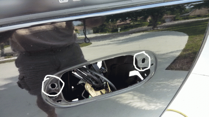

With the lock mechanism freed from the door, remove the exterior door handle by removing the two 11mm nuts on either end (accessed from the inside of door...) and remove the two connecting rods from the handle, set it aside out of the way....

This was the old pin switch, notice the ball plunger is mashed down (not even showing anymore...) and will not pop up . No amount of solvent, lube, degreaser, was gonna fix that....
