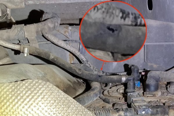

Something to note here is that the fuel gauge turns off/on.
Also, something else to note is that it only takes 5gal of gas at a time.
The most likely suspects have already been named but I once had the above two symptoms on my wife's F150 and it turned out that a rodent had chewed a hole in the vent hose above the tank.
It was easy to get this picture of the top of the F150's tank but I can't find a place to take one of the Expedition's.
