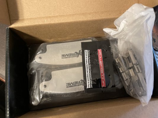

I can attest to powerstop, I've used their products on my last three vehicles including this expy and have been great. I travel mountain passes a lot and needed something that wouldn't warp when you drop 4k ft and then have to sit at a stand still in the inevitable overcrowded I70. The factory rotors warped pretty early on. These are doing great and look nice too.

Two things come to mind with brake pads. Personally I've used Power Stop which performed as advertised. Anyway, To get the best performance one should "bed" the pads after installation. Also, when after getting the brakes hot, if possible, when stopping at a red light or traffic don't sit with your foot on the brake.
