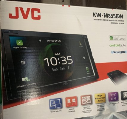

I have a 2010 EB and put this in with the Maestro. Absolutely love it with the wireless carplay.
