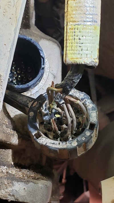

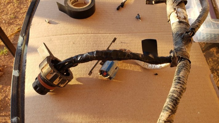

I replaced the trans pan gasket as well as the transmission bulkhead piece and that seemed to solve all of my leaking issues. . . That was causing my fluid level to go low in the trans and then it would start to shift slowly and jerky. After getting it buttoned all back up with the proper amount of fluid its much better. Its still down on power when warm so I will look more into it.

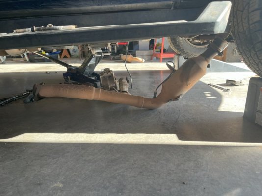

Timing kit was already done, but the phasors and solenoids are original. Engine is whisper quiet and you can hear the injectors clicking away its so quiet. I did just find out I have a couple broken studs and a slight leak on one side of the exhaust manifold.

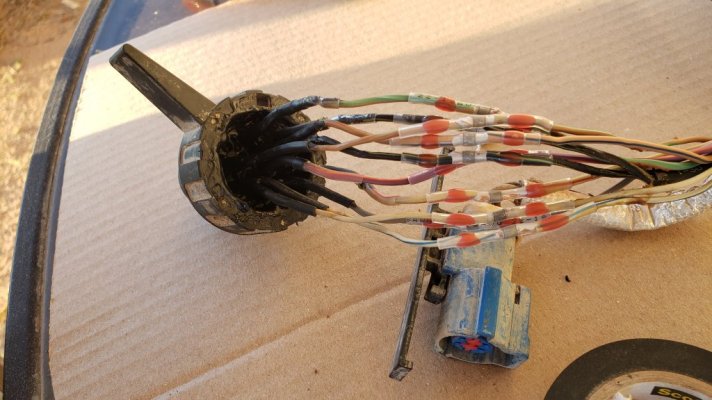

I replaced the noisy fuel pump assembly as well as fuel filter Sunday, Pump is significantly quieter and power seems to be back up to what it was at when I bought it. I dont trust that its fixed or anything because the truck has its days where it goes from great, to bad. It now has the power to peel out, which was never the case before so I'm hopeful. . Hopefully this is not a temporary thing and it continues to preform but only time will tell. I will keep this thread posted.

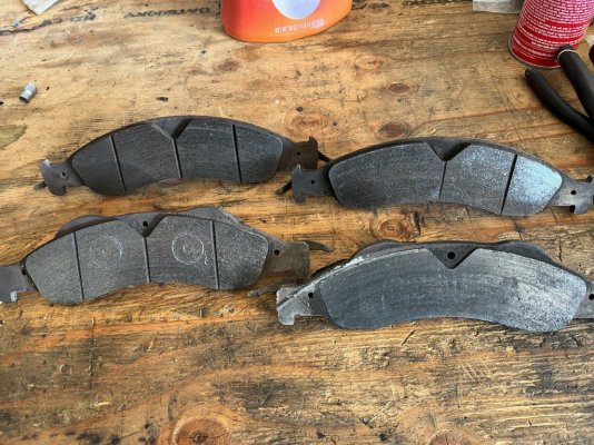

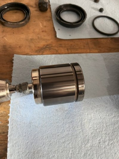

Edit:
Other things that were done in the last 20K miles
New motorcraft fuel filter
New Motorcraft upstream O2 sensors (the ones responsible for AFR),

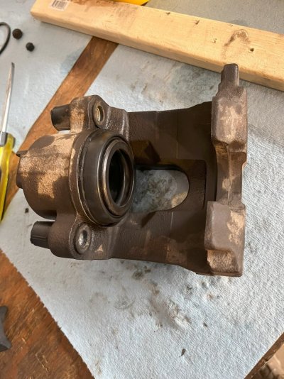

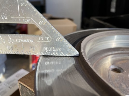

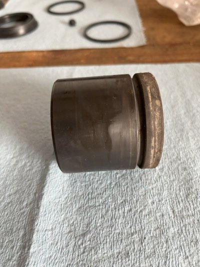

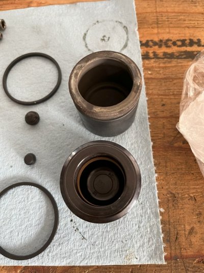

new front and rear brake pads and pins (polished and greased)
