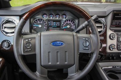

OK, this is interesting! According to Motor Trend, the 2015 F250 Platinum has a wood/leather heated steering wheel. This wheel happens to be the same design used in the 2007-14 Expedition. SO, if it can be confirmed that this wheel is indeed heated (we'd need to confirm by looking at a Ford F250 sales brochure) then it might be possible to add a heated steering wheel to any 2007-14 Expedition without having to deal with customizing the buttons!
AllBoostNoEco
May 2, 2017
328
195
GA
Ford’s 2014 Super Duty brochure says the Platinum came with one. If the wheels are the same, then it just might be possible. It sure wouldn’t be the easiest mod ever, but if you want one, I’d encourage you to go for it.
Wish the 15-17 Expedition had a vehicle it shared the steering wheel with that came with a heated one.
6,510
3,124
This is correct, the steering wheel in my 07 Expedition is the exact same as in my 2013 F-350, so maybe possible on our 2007-2014 units. My SD wheel is leather wrapped with the controls but I don’t have heated.
