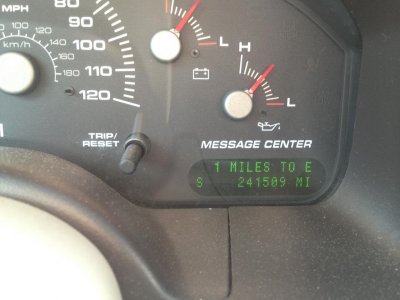

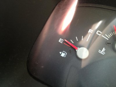

This is what was shown on gauge the other day after putting in $10. Today I dropped $10 in it and the gauge read the same thing. After driving it for around 5 minutes and parking it and starting back up a few minutes later the gauge went up to almost 1/4 and read 80 miles DTE. One would assume its the sender. Odd thing is that it was doing this before the sender/pump was replaced. So its tells me that something else is causing this inaccuracy.
