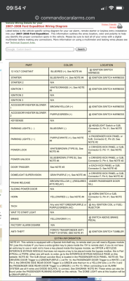

I didnt think there was a second ignition to hook up and looking at the direct wire sheet that is the case so no idea what they have going on there.

As always very these wires w a meter before making connections. I've had things listed incorrectly in the past. Kinda the cya part of install...
