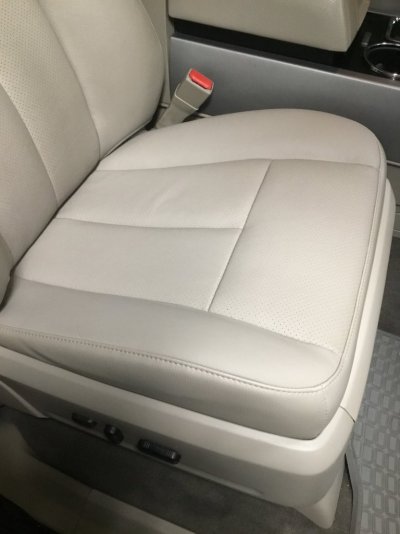

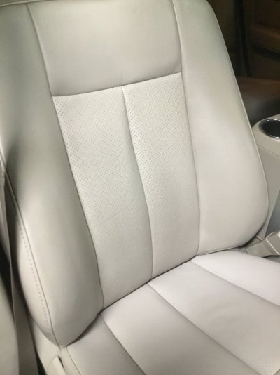

I have a 2012 Limited 4x4 and I recently had both front seat bottoms (passenger & driver) replaced as they were cracked. The upper's were still in great shape and didn't require replacement. Although i was worried the new bottoms and old uppers wouldn't match but he assured me they would. I first called Ford dealer and they wanted $3000 to replace both seats...So I went to my local auto upholstery shop and I couldn't be happier...total cost $ 752 dollars. The seat looks amazing and look completely factory stock down to the color and material quality...
He ordered mine through "The Seat Shop" in Texas 214-710-2565
Here is another place to get seat covers if the The Seat Shop doesn't have your year (UF Auto Covers Texas) 281-691-2859

@Joe S - We'd love to see photos of your seats if you have any to share!
