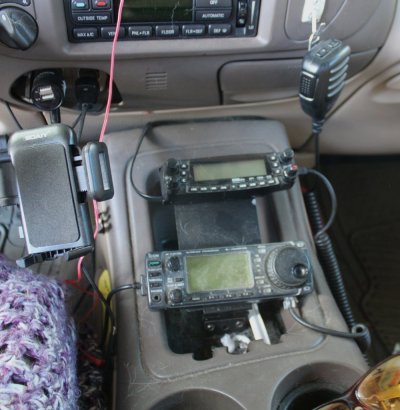

While a little older than yours (99), I hope this helps. Made a metal plate and two hinges that sloped up near the dash and installed this just in front of the center consoles cup holders. I mounted the remote radios heads to this plate. The radio bodies are mounted to the floor behind the drivers seat (near needs to be adjusted). I ran a single 4 gauge cable back to where the radios were, the was fused at the battery end. At the radio end is a small fuse panel that then feeds power to the radios The power and remote cables run under the center console, while the coax runs under the drivers side door kick-strip.
When I can find it, I'll add a photo
Simon Clowes
Mar 25, 2021
21
Vancouver
COuldn't fnd one so I went out and took a quick one. Ignore the hair - that result of having a Husky/Sheperd Service Dog is hair EVERYWHERE..
