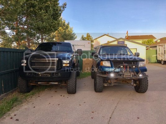

Very nice man, though looks like a scale model car next to the super duty haha
Your roof rack is that of a 03-04 expedition not the 05-06

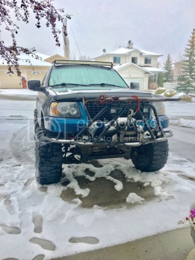

Have you had any issues with the 37s? Or have you regeared?
Not in the least been running them and wheeling for a year with this setup daily driving no problems on stock 3.73 gears , replaced the first rear cv not long ago but has never been replaced since I owned it under some pretty gnarly conditions . Was gear hunting on the highway but an edge CS programmer In a tow tune fixed that problem

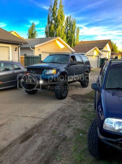

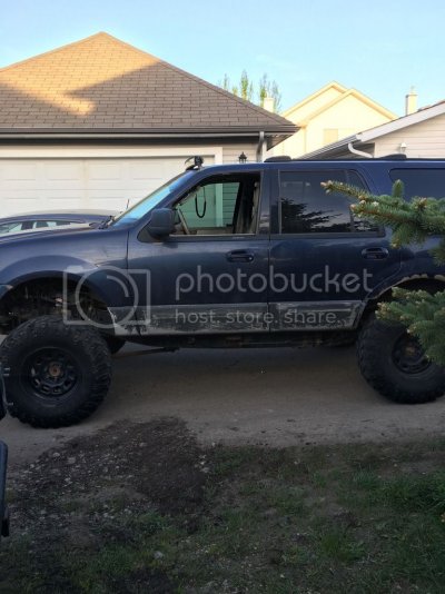

How did you get the rear end up that high? body lift too?
I converted the front suspension to f150 from the upper control arm down with a 6" lift I modified I made a thread about it.. and the rear is just a 1.5 spacer and 3" body lift all around. Reason for the 1.5 is for the cvs so they aren't so stressed was thinking about bumping it up to 2" but like I said the cvs have been really good to me on these 37s and my last set of 37s as well
