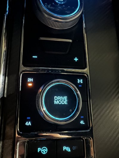

My 2020 Epxy XLT with the "F4" off-road package has the same choices that @SyndicateZ showed in his photo above. https://www.expeditionforum.com/threads/4h-4a-2h.52689/post-484657. So I don't have a 4L, but I have the same icon with the 4 tires in the top right of his photo. I think this has something to do with the towing / locking differential, but I'd appreciate it if someone could give me some layman's explanation or point me to links to read on what this is and when or how to use that setting.
background: I was just in Steamboat Springs CO for the month of January '24, and our expedition did great! I used 4A with Snow/Ice/ Gravel drive mode virtually all the time as there was either ice, snow, or snow-packed icy road most of the month. I did feel I needed to use 4L setting once or twice at a very low speed when we had a 2 foot snow and I was having trouble getting the car out of a very slight slope or it was so deep I felt I was getting stuck. in 4L I tried to stay in the 10-15 mph range and stopped and shifted out.
Any tips or advice would be appreciated for the set up we have with the F4 package ( i.e. no 4H choice), as we will be out again in Winter driving next year. Also thanks to @LokiWolf and many others who guided me in prior posts to drive the 4000 miles RT with just new M/S tire treads and steered me away from trying to drive out there on true snow tires - great call!
