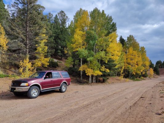

Went out for ~5 hours today in the mountains. Took on some moderately challenging obstacles without issues. The rest of the mods will help for peace of mind, and frankly I'd like to replace every single suspension component in this thing I think haha. It definitely has more play than it should.
But honestly I had a blast already!
