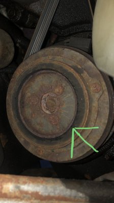

ac finally went out during the hottest 2 days of the year up here in western ny, has anyone changed the front clutch hub? I see one bolt in the middle but I’m guessing it won’t slide right off.
The clutch rubber dampener broke free in the center

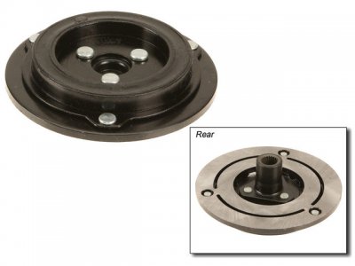

That's really rusty??? Yes it just slides off after bolt removal. I use oil filter pliers to hold while loosening.

I was getting the 3 round rubber vibration thingy ones but other style like the one you show fit too.
I found that there are two different common spline sizes. One ever so slightly smaller.
The 8mm bolt is the smaller splined shaft and the 10mm is the larger. Too easy..right?
Some were stuck pretty good. You can spray penetrating oil in center hole but I don't think it helps. I used two screwdrivers and worked them off. Of course I prefer the ones that slide off. You can bend it too much and create a problem, but getting old off it doesn't matter as you are tossing that one.

I was replacing one on an aftermarket comp but it fits volvo semis. The EXACT clutch front was on many Nissans. I think I pulled one off a Murano.

"Slide off" is a misnomer. The center bolt is all that holds it on, but it may be stuck and need some persuasion to get it off. Installing the new one is the *****. As you remove the old one, watch carefully for any spacer washers behind the clutch that sit on the shaft. You may need them for the new clutch.

Only when they look that bad! I slid 4 off last wed with nothing but finger pressure. Much harder to hold the hub to loosen the bolt than take off the front...but one or two would not move. Some slide, some don't.

the salt wasn’t friendly to her in the past 12 years, Thanks for the reply’s
