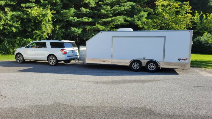

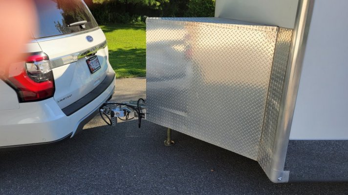

I have been towing an enclosed car trailer with my Expeditions three or four times annually for 15 years. I have always used a WDH. I started with a 24' Steel trailer (that was heavy!) and for the last many years been towing an ATC aluminum 24' trailer. It has always towed well - I get a bit of suction when the big rigs blow by me but other than that no issues. I recently upgraded to a 2020 Expy Max with heavy duty towing package. A week of so ago I had the opportunity to buy my dream trailer in VERY GOOD condition. It's a 20' JimGlo - 7K gross. My other trailer is 9900 gross. With my heaviest car I will be at 6600. This trailer has a very nice generator and storage box on the front which prohibits normal WDH brackets. See photos. I want to run this trailer SAFELY. Can some of you towing veterans give me some suggestions? Am I risking it if I run without the WDH? The Expy is not sagging when loaded with the car and the tongue weights are within limits. Thanks for your time! Dave

I wouldn't tow those numbers without a WDH. I would have the generator box modified to allow WDH. My guess is it could be done with some cutting.
How about a pic with the tounge jack up and fully loaded. Including people and gear in the expy.

According to the towing guide, anything over 6,300 lbs on a Max 4x2 requires a WDH. It sounds as though you'll be slightly above that. I think you can have the WDH brackets bolted directly to the trailer frame, or get the generator cover modified by a reputable trailer shop to permit installation of the brackets . I think this would be the best course of action, since you're towing a fairly heavy trailer.

Thanks everyone. Problem solved. Both Curt and Reese make chain brackets that bolt to the trailer frame. Guess I have a small project upcoming !
