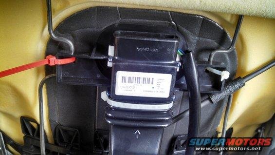

Unzip the back of the seat and you will see the thermo device ( funny looking black piece ) You should be able to hear the little fan inside it when you turn on the heated/cooled seat. If not, but the bottom still works, I would say the thermo device needs to be replaced.
Matt

Thanx for the info. I'll be unzipping today and checking the unit behind the seat. Will post results..

I will check it out tonight! Whats weird is its both seats backs Driver and Passenger don't work.
Thanks !
