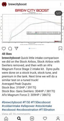

I want to test air flow, power output, fuel efficient changes, etc....see actual numbers instead of just hearing half the internet say their worthless and the other half say they’re great.
I got time with the 'rona shutting everything down...

Brew city boost already did that. Now one thing that ppl need to remember is that with stock tstat and intercooler, repetitive pulls on dyno always show a decrease in power output due to heat soak especially on the ecoboosts. Here are their results. I still don’t believe it and there is nothing you will be able to notice unless you have a datalog device. Very minimal gain/loss

You will see no fuel efficiency changes, you won’t be able to feel a power difference and air flow is pretty much unaffected. I removed mine and added a k&n CAI solely bc I have a tune

Looks like stock produced more HP and torque. Not much but more. One has to question why change it other than it looks cool :)

Noise power, not horse power. That’s why. Just another real world dyno showing CAIs add like 4hp. Not worth it unless you’re tuned
