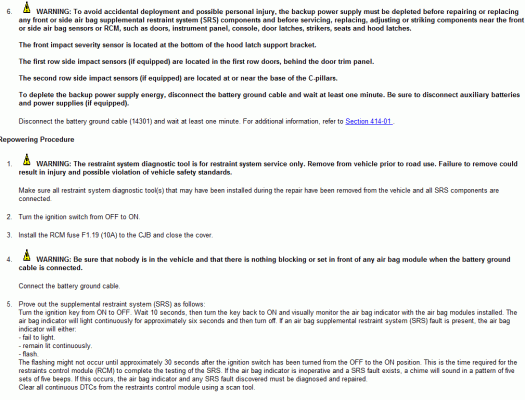

Air bags will not deploy while warning light is on.

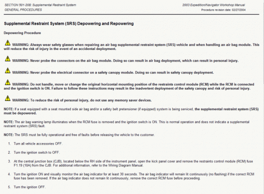

You may try to reset:
Hope this helps
Thanks I'll try that, if it is blinking an error code should I turn it off after the
Hope this helps
Thanks I will try this.

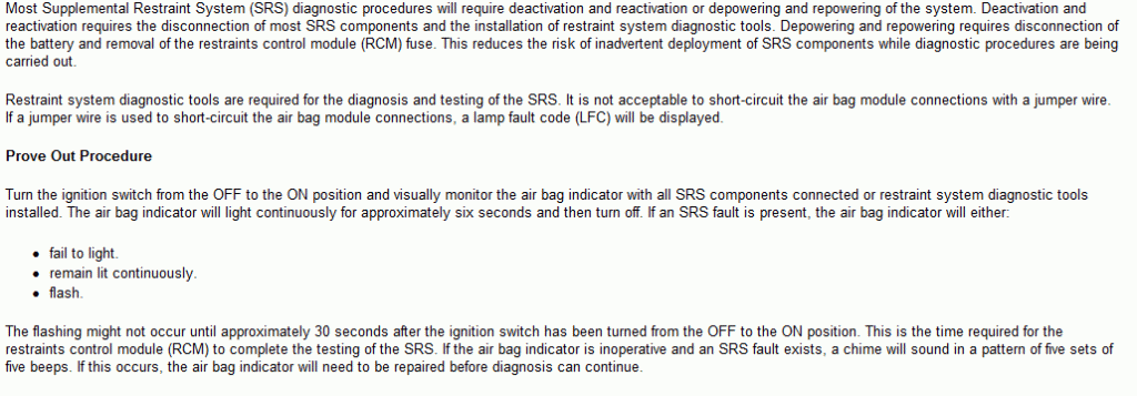

Does on in this scenario mean engine on, or just my electrics on?
Also my light seems to illuminate for more like 5 seconds, then begin to flash code; do I switch off then, before the code flashes?
riphip
Nov 6, 2018
641
189
Memphis, TN.
Sorry Sean, haven't been watching this for a couple of days.
Immediately when it stops flashing.
Since I have not had to perform this, you may have to follow this:
Hope this helps
