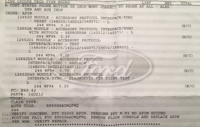

That stinks. My 2017 SYNC 1 APIM just went out with under 500 miles left on my warranty. Dealer had my Expedition all week, still waiting. I got lucky it went out under warranty.

Just got mine back today. Curious what the price would have been if it wasn’t still under warranty ...
