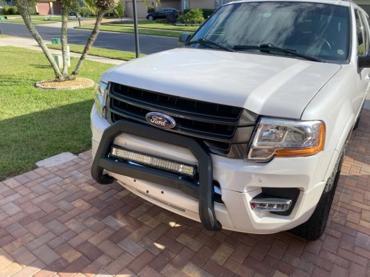

I had some jerk brake check me on the interstate and I hit him. Thankfully it was recorded on the dashcam and the police gave the guy a ticket for reckless driving once they saw the dashcam video. To make matters worse he had no insurance. I will have to file a claim against my collision and pay my $500 deductible.
I was disappointed that my
Armordillo Bull Bar did not provide as much protection as I thought it would. It was an expensive purchase that looked nice but offered no real protection. I can't but think if I didn't have this bull bar, the damage would have been less severe.

That is a problem with most bolt on grill guards/ bulls. They end up being damage multipliers. Any real impact and they fold up onto the front of your vehicle. Pretty much cosmetic, no protection.

Yeah almost all of those bull bars are basically just a place to mount a light. They're definitely not heavy enough or mounted in a manner that would give crash protection.

You gotta remember it's mounted to the front frame horns that have crumple zones built into it. So even if the bullbar was made very HD, the frame would still compress to ease the impact.

Yup. +1 on that. They're cosmetic, not protection. Sorry the OP thought spending more was worth more.

There isn't much in front of these things anyways. The damage you incurred is probably similar but just higher never the less it still sucks either way.

We've stopped installing "push bars", which are really just equipment mounts, on our fleet of police vehicles. As has been mentioned, in my experience they cause far more damage than they prevent in even minor front end collisions. Plus in my state PIT maneuvers are illegal except in lethal force situations, so at that point who cares about damaging the front bumper anyways.
They now sell these grill light brackets as an alternative for mounting lights.
