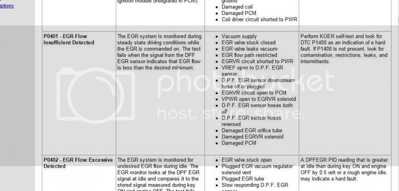

Well today I got a check engine light and checked it with a code a reader to find it is P0401. I have been searching the forum and doing some reading on this and it looks like the EGR sensor is most likely the culprit. What I am wondering is should I replace the EGR valve as well as the EGR sensor? I have 119000 on the truck so I am sure these items have never been replaced. Any input would be great.--Thanks1

May want to check vacuum line to the egr valve and make sure the hoses on the dfpe sensor are good 1st.

I picked up the sensor yesterday and am going to install it and check out the hoses today. I will probably drive it and see if the code comes back and if it does do the valve. I think I read other people were having some hesitation issues also.........I am too at lower speeds (it is fairly minor but it is there). I am wondering if this could be part of the low fuel mileage issues too? Any more input would be great!
