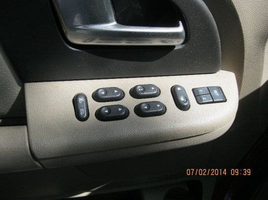

Do these light up?

The memory switches and all doors lock/unlock on driver door? Windows up/down and windows locks do.
If so, how easy is it to take it apart? And may be fix it.

Uhm, yeah the window switches in my 05 EB light up. I'm pretty sure that the door lock switches are supposed to be illuminated along with the window switches on each door. Most of mine are not working, along with a few on the dash...headlight switch, 4x4 switch. I took care of several instrument cluster lights last weekend when I installed a new JVC head unit. Gonna do the others when I replace the faulty SWCI module next weekend.
My 99 Crown Vic has lighted door switches, but no lighted steering wheel buttons. My 03 Sport Trac had lighted door switches and steering wheel buttons. In fact, the door lock switches would stay lit for several minutes after shutting down and locking up...maybe ten minutes or more.
I would say take them out and see if there are bulbs in them. I think they will be something like T-5's or so....got mine at Radio Shack 'cause I didn't wanna wait to order them from eBay. Course you could also look into LED replacements and choose all sorts of colors....Me, I just like a nice pure white, but not too bright......There's enough distractions without creating more.

Ok discard my early message, I actually pay attention tonight to the switch , and it does light up, never pay attention before until today lol. Anyway so all my switch are light up.
